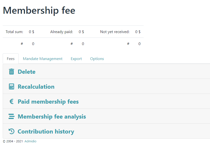

Re: Membership Plug-in
See the attachment after the translation. Euros seems to be hard coded in instead of pulling the actual currency unit. Mostly just in the menu item.
- currency.PNG (25.01 KiB) 57755 mal betrachtet
The € symbol is not hard-coded. Look behind "Total sum:"-> 0 $.
However, the symbol in front of "Paid membership fees" is hard-coded. It's an icon from the "Font Awesome" library. This symbol does not depend on the set currency, it should only represent "money".
