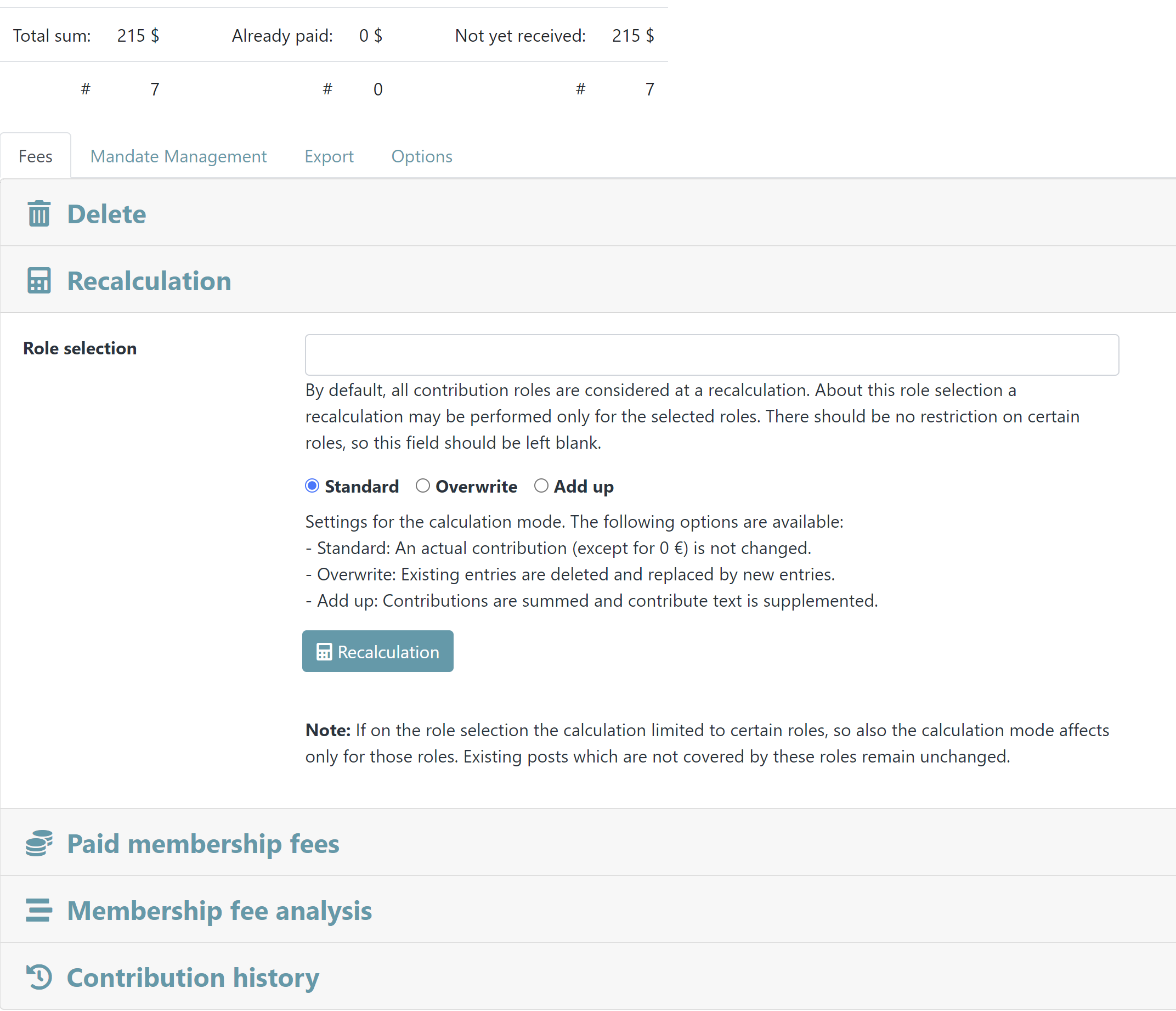

Re: mitgliedsbeitrag - English Translation for Plugin Page?
See the attached screenshot.

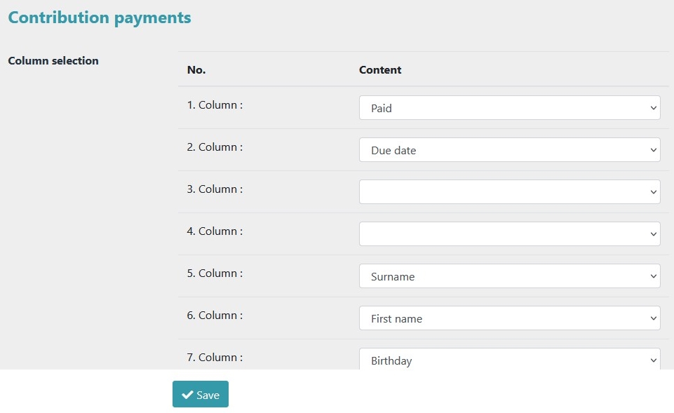

If you have started membership fee, there is a link to "MEMBERSHIP FEE" Preferences in the menu on the left (at the top). In the Preferences menu there is then "View definitions".
Please check whether there are empty fields under Content (in Preferences-View Definitions). All fields must be filled here.
There are columns missing in the view. What should these be set to?
With a new installation or after an update, it may happen that profile fields created by the plugin (e.g. "Due date") cannot be read. This then leads to these empty, unoccupied columns.
It is not necessary to specify a specific column here, it is sufficient if the save button is pressed (this will overwrite the incorrect configuration).
