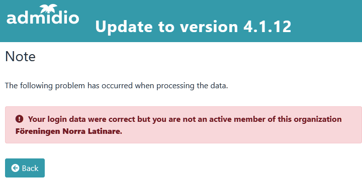

When trying to update from v. 4.0.12 to v. 4.1.12 user credentials are confirmed during database update but the admin user is said not to be a member of the organization (see attachment). There is only one organization on the server, and only one administrator, and the admin account works otherwise and is definitely a member of the organization.
Is this a known problem? Server is running on Debian 4.19 with PHP 7.3.31 and Postgres 11.13.
Could perhaps the non-ascii letter "ö" in the organization name be an issue here?

Hi Rolf,
unfortunaly we don't know this problem until now.
Which version of PHP are you using?
Could you please replace the unzipped file of this message to the folder adm_program/system/classes and perform the update after that again. Does it now work?

Tested now, but unfortunately the same result. Could it be Postgres related? I noticed when I started using the previous version (4.0.12) that member name searches unexpectedly had become case sensitive.

it could be a problem with postgreSQL. But in my tests it works.
But anyway you could disable the registration for update bei setting the parameter $gLoginForUpdate in the config.php.
https://www.admidio.org/dokuwiki/doku.p ... config.php
After the update you could remove the parameter.

After changing registration for update it was possible to continue with database upgrade - thanks for the tip!
Searches remain case sensitive (search for "peter" gives no hits, search for "Peter" gives several hits). Is that intentional?
And one more concerning oddity: Edit lists opens a blank page, so no way to configure lists.
