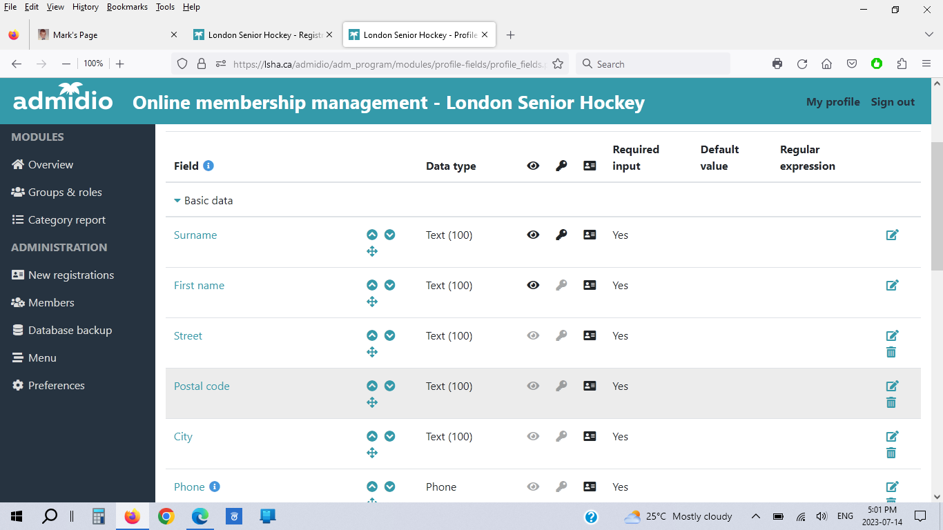

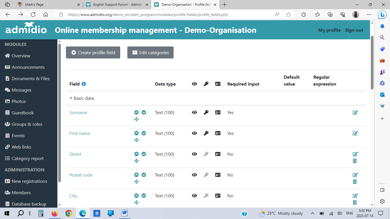

Beitrag von mlowe »
The settings are identical...
My Settings.png (103.27 KiB) 30298 mal betrachtet
Demo Settings.png (116.57 KiB) 30298 mal betrachtet
I can change the "No" to "Yes" in the Demo (Required Input) and a red dot appears, back to "No" and it disappears.
In my form the red dot never appears When "Yes" is selected...
Thanks
Mark
