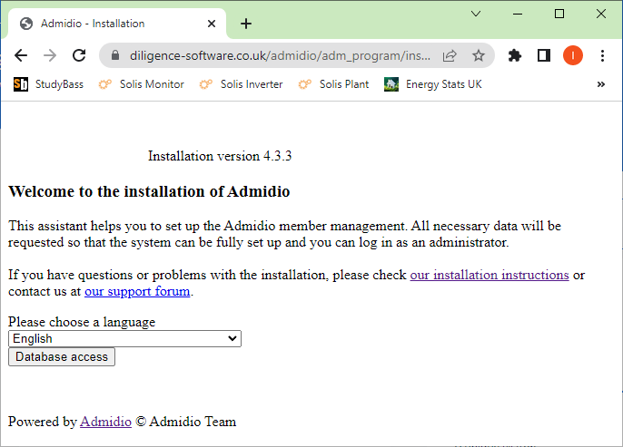

I follow the Instructions within Documentation, installation steps 1-4. However, I don't get the "pretty screen" shown in the instructions, but this:

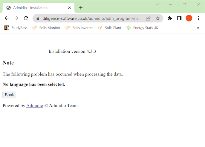

I want English, but I have also selected other languages with the same result. When I click "Database access" I get this:

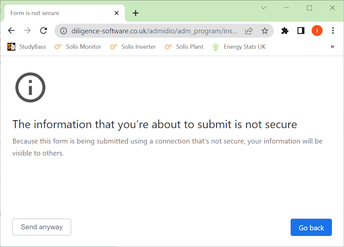

So I click "send anyway", and get this:

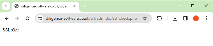

Yes, see result below, cheers Ian.
Re: Installation Failure
Thanks for this check. I think I found the problem. Our check for the value of the parameter is not case sensitive. In your case On is written with a capital O and we only check for lower case.
